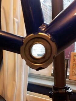

Apologies for the necromancy but I didn't see the point in starting a new thread.
Having a bit of difficulty getting the cups on. They seem to stick when they're hardly into the frame, and I don't want to force the issue and strip the threads. Am I being overly cautious? I have greased cup and frame lightly.
Again, any advice much appreciated.
AndyRM
AndyRM
XOXO
North Shields
My early evening enthusiasm from last night has been dented. Didn't have enough time to finish due to making dinner for a tired wife and discovered that while I can get the non-drive side on with no issues, the drive side refuses to screw in.
Initial thought is that I'm trying to put them on the wrong sides? One of the cups is completely smooth on the outside, while the other is indented. Currently have the indented one on the non-drive side, attempting to put the smooth on the drive.
Have I got them the wrong way around? Driving me mental(er)!
