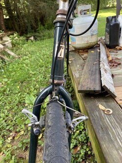

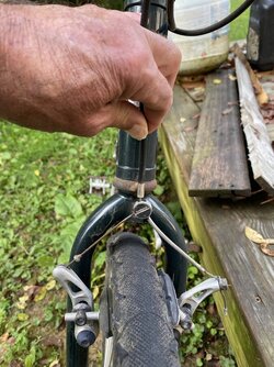

No I just let it go , I’ve been using the back brake only but there’s been a time or two I’d a felt better if front brake was working . I’d like to have a cable hanger like the original one , the serial number on my bike is 1112995 , when I bought bike it had a front shock w/ built in cable hanger , I put the original fork back on but it didn’t have cable hanger . There’s a hole in top center of fork I think is where hanger goes ?
