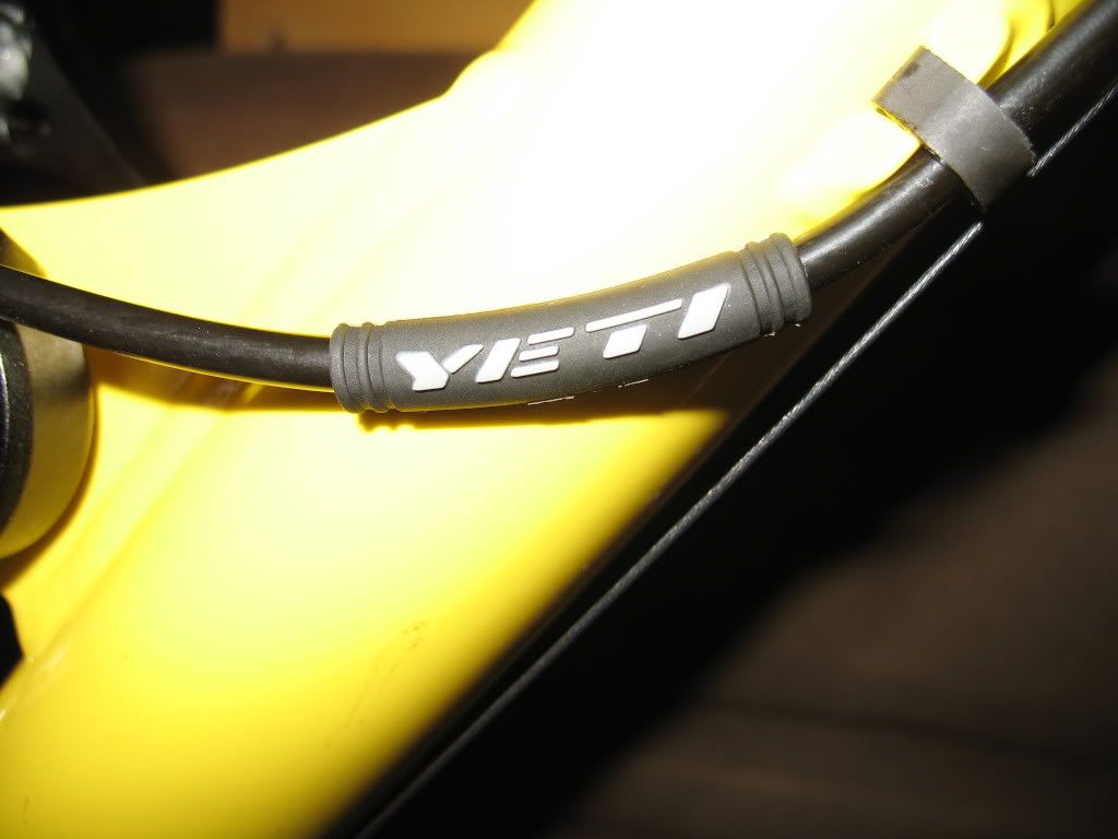

Some rubber frame protectors where the cables are rubbing or hitting against the frame may help silence it a bit.

Frame protectors, tape and gently bending the cables so they don't touch the frame (PS not for the ham fisted as you can wreck the cable travel)

i'm surprised you can hear the cables knocking against the frame, i've never had this. if it good to use pards or helicopter tape to preven the frame being rubbed and worn away by the cables and brake hoses. ... if you are cheapskate, 2 layers of insulation tape works just as well.
