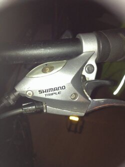

anybody know how to remove/ replace the brake cables on these ,,i cant see a way in ,,iv removed the cover and still none the wiser ,,hidden fixings ?the cable is just a bit stiff and doesnt release really freely

IIRC you only need to remove the cover to replace the gear cables. Pull the brake lever hard and you should see where the brake is connected - possibly only visible from underneath.
Pull the lever and you will see the end ferrule (it a small circle at the end of the wire) in a small metal bit that attaches to the brake lever on a pivot remove it, assuming you have cut the cap of the other end and released the allen key bolt at the v brakes. Its a the reverse for installing the new cable. Theres a slot in the pivot/ shifter housing to aid installation removal.

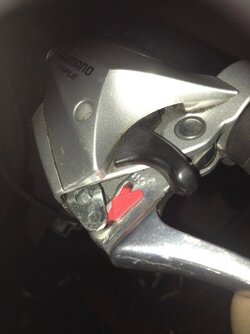

i just loosened the end at the brake assy and pulled it through ,,greased /oiled it a bit and buttoned it up ,,changing it is something i cant figure out lads :blush:

Make sure tension is off the cable, pull the lever a bit further than in the picture, and you should be able to unhook it and remove it from the front. When I pulled the lever with the cable slack it actually came out itself when I pushed the lever back. That round bit in the picture is the hole where the metal ferrule should sit. Your's has rotated a bit meaning it isn't sitting properly - mine does that as well. Pulling the lever a bit further allows that metal bit to swing down to remove the cable. I've no idea what the red plastic is - I don't have one of them.
Have you sorted it Jim, if not the brake cable end it just in that wee metal cage that pivots of the lever just below those red plastic things. If youve released the cable tension (removed the end cap and released the allen key screw holding the brake cable at the vbrake arms) you should be able squeeze the brake a little further and move the cage to a position you can pull it out.

The red tab is a switch that allows the lever to pull the right amount of cable for different brake types (V vs Canti/road).
The first thing to do is to unhook noodle at V brake or loosen quick release if caliper brake. The second step is to wind the cable adjuster and its stop at the lever right in, and then wind them back out just enough to line up their slots with the slot at the lever housing (so that the cable can slip right out). The third step is to pull the lever back enough to slip the end barrel off its "cage" and maneuver the cable off the lever.

As for getting the cable out: On the pic the bit that i've cross-hatched in blue is the "cage" referred to above.
the bit I've coloured red is the "barrel" - which you are going to need to rotate a bit.
In the back of the cage is a slot for the wire to pass through when the barrel is lined up with the cage.
As RAFN says you need to have the cable slack and the barrel adjuster slots lined up with the cable slot on the back of the cage.
Does that help?
