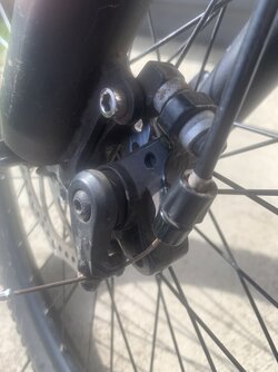

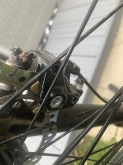

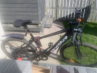

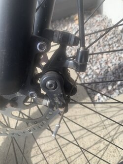

Hi I have an e bike, trying to fix my front brake why had poor braking anyway, ive ended up with no breaking now. ! Ive took a cpl pics, does this look normal for disc brake pads ? Ive no cycle and working tomoz. ! Any help would be brilliant?

None of those images show the brake pads themselves. I recognise the brake mechanisms though which are typically supplied on very cheap bikes with disc brakes. They are basic single piston calipers so only come in from one side. You should be able to follow various youtube videos showing how to adjust them but you need to remove and check the brake pads for wear first in case they need replacement. Also you need to check the rotor is completely flat by spinning the wheel and making sure the rotor doesn't wobble. If the rotor has been pushed too much to one side due to poorly setup brakes the rotor may not be completely flat. They can be adjusted to work reasonably well, the issue with such brakes is as the brake pads wear they will need to be re-adjusted manually from time to time. If you need to get replacement brake pads they are often on ebay or aliexpress for not much money.
Brake pads shown in image one and two. Looks like they are in backwards and possibly not the corret pads for the caliper.
New pads, right way round, clean the disc and bed in. See where the OP goes from there.
I actually meant out of the caliper so we could see the surface on them properly to see if they are worn or not and how they are worn.
Given the rust over the front end and the pads in backwards, you can probably assume the pads aren't in great condition and for a tenner it's easy to swap them out.

Take pads out to check for wear and contamination. Often folk think they are worn out when in fact they are covered in oil or othwr contaminent. Whichever treat yuor self to a new set and fit them properly - plenty of advice on youtube.
