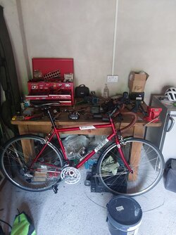

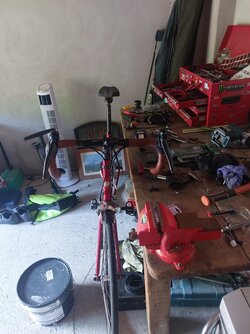

Hi guys I had a bike fit after all I paid the £150 for an 2hr set up. I took my bike to cyclepodea its a good bike shop in wales. He asked if I wanted to basic bike fit that was £45 or the full hog, so as a fathers day present I said I'll have the full set up check.
He asked what was the problem I said it was .y neck , and that I didn't want a racing set up just a comfortable one for all day rides. So he put my bike on this roller set up where he could clamp it down and have a look at me riding. I'll make this short he moved my seat up brought my seat to the middle of the rail and put a 110mm stem with a massive angle so now it looks right high but when he showed me because he took a photo I was lower that when I first came in.
I changed yhe stem the other day to a 80mm thinking it would be better for my neck being closer to the handlebars as I thought I didn't have enough bend in my arms. Anyway it feels much better now but it looks a bit strange now more of a touring bike I'll take a photo I'm not sure about the handle bars.
