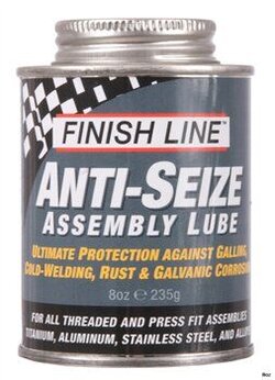

I use Finish Line Anti Seize Grease, has a brush built in and enough to last years.
