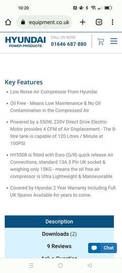

A few months ago I bought a very small 8l air compressor for Brad nailing.
I was wondering if this would have the capacity to inflate a 28mm road tyre to about 80psi very quickly (to help seat the tyre (non tubeless) as part of the tyre is not sliding all the way up to the rim wall. I can get it too fit but it takes several attempts and lots of messing.
Specs attached.

Your tyre volume is about 1.3L, the compressor says it will deliver 120L/min, so by my reckoning it will take something of the order of 60*1.3/120 = 650ms to inflate the tyre. I don't have any experience of tubeless, but that sounds to me as if it's likely to be quick enough. I'd make sure the air pressure in the tank is no greater than the safe rated pressure of the tyre before trying it though.

That compressor delivers two litres per second. The pressure switch on it won't act instantaneously when it reaches the set pressure so there's a real danger that you will blow your tyre to smithereens in the blink of an eye.
