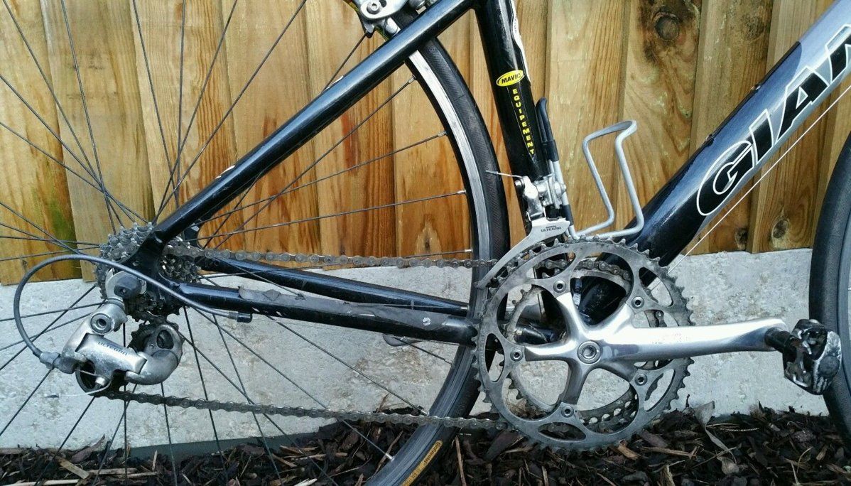

D
Deleted member 41544
here is a close up of the chainset. how much life is left in it?
