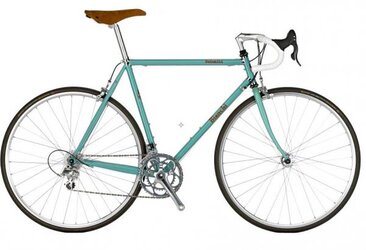

Hello to everyone out there on CycleChat,
I'm a new poster on here, hoping for the benefit of your combined wisdom. I've been a mtb commuter for about 15 years, and before that I had a Raleigh 'racer' which had 5 gears, weighed at least 35lbs, but which I covered most of Northern Ireland on in my youth. I'd like to get myself a drop bar bike for longer (30-60mile) weekend rides, and my preference is for old school straight thin frame tubes, so I'm either going to buy an old wreck and rebuild it or win the lottery and buy a Bianchi Dolmitti. My question is, would I be able to put modern running gear like bottom brackets, wheels, gears, derailleurs etc on an old racing frame, or would I have to source old bits to put an old racer back on the road.
Apologies for the length of the post - once I get my 'racer', I'm hoping to join a cycling club. Then I'll have an outlet and maybe some new friends to bore instead of you guys!

As for the Dolomiti...:tongue: :thumbsup:
