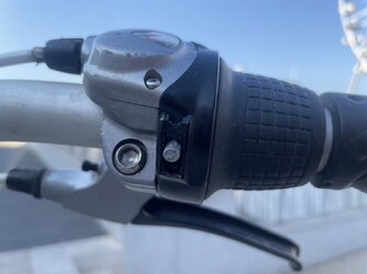

This is the handlebar in position 2. When I try to change to 3, it feels like the little metal nose that sticks out gets stuck at the bottom of its travel, it doesn’t actually feel like the force is getting as far as the hub.

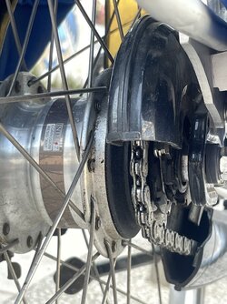

And a still photo of where the gear cable ferrule is in position 2, about horizontal so level with the bottom of the chain guard. Position 1 is a little further up into the chain guard.
I’ve never played with a hub gear before, but could something have slipped such that the cable motion is maxed out on the hub in one direction and in the other direction on the twist shift, hence the limited range of motion?

I hadn't adjusted anything on it, it's a rental bike so I was panicking that I'd broken it and they'd make me fork out for a new hub - turns out the little metal nose that was sticking out on the twist mechanism, I pushed that back in and now everything is working exactly as it was this morning! Glad it's fixed but a little unhappy that I only thought of trying that a few hundred metres before home, rather than 21km ago!

Cable related things are far more likely to cause problems than internal hubs going wrong. I've had a couple of bikes with Nexus 7 gears and haven't come across this before.
Do you know what that little metal thing that stuck out of the lever mechanism is for? I'm guessing that's just for cable pulling, and isn't necessarily related to the type of gears (derailleur or hub)?

It's the cable.
Ah okay, that might actually make sense, if I changed down too far too quickly (new to hub gears) and the slack pushed the ferrule through the slot on the levers it would have jammed there and the weird tension have put the shifting out of alignment. Glad it was a cheap fix anyway!
