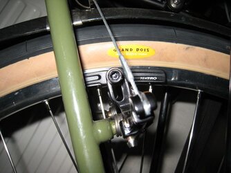

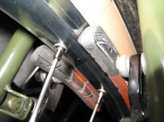

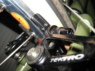

So just wanted to confirm that it is possible to fit 650b wheels with Tektro cr 720 brakes. Need to use the inserts that came with the brakes as the Koolstop pads I'd fitted a while ago wouldn't reach.
Not enough adjustment for koolstops:
but the tektro's just fit at the top of their adjusment range:
close fit:

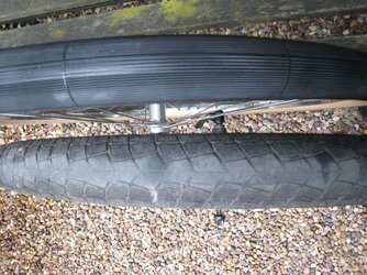

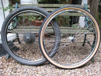

Side by side 26" Big apples (2" size) and 650B Hetre Grand Bois 42 size, theres not much in it. It was a straight swap onto the bike:
almost the same width:
only had a quick test ride, not sure if they're an order of magnitude better but they certainly roll along very nicely and make a nice humming sound on the tarmac. So pretty pleased it all worked
