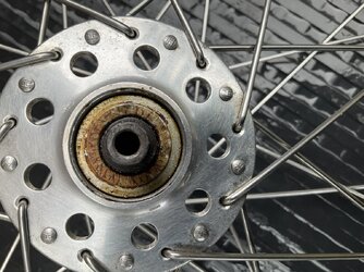

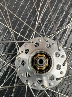

Trying to find any info on these hubs from the 1980s ,cant see how to remove cage bearings?

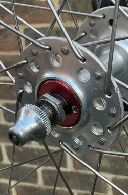

Are they caged? Decent hubs rarely use cages.
Paulus
Barnet,
Looks like normal cup and cone bearings.
Take all the nuts, locknut and cone off of that side of the axle, and the axle should slide through the other side.
The red part will either come out on it's own, or may unscrew from the hub to reveal the bearings.

No name on the hub but are mavic rims.I will remove red cover again and take another photo.The rear hub is the same,I have removed red covers and cones but axle wont come out?.

Here is a link that may be of some use.
It's a bit long but does get to how to change sealed bearings if that is what you have.
https://viscount-lambert-bikes.blogspot.com/2011/05/sealed-bearing-hubs.html?m=1
Thanks for reply,I think they are sealed bearings with the outer seal left off.I will have another look later.Thanks
