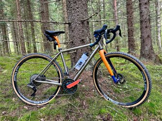

I built my older Serotta ti all road with Dura Ace Di2 (11spd) and GRX 1x rd. Ran 42 on 650bb gravel and 30’s on 700cc road wheels. Now building new one for wider gravel tires, 42’s on 700cc and 50’s on 650bb. Would still consider that same as my priority option, yet would just need to run Dura Ace rd until GRX Di2 is launched and suffer a little on the steep bits.
On 11spd I had 11-34 on my road wheels and 11-42 on gravel and assuming could go upto 11-46. Chain is finiky to adjust and will not take wear as long as normally, also I ended up swapping the front rings to new ones earlier than before. Yet I think it totally has been worth it.
1x grx rear derailleur does not work with 2x. It doesn't have the capacity. If you get the 2x derailleur then it'll work fine with 11-36 11spd cassette. Then you can fit 46/30 direct mount chainring on aldhu so you get 36-30.
Yes, 1x GRX Di2 will work pretty perfectly with 2x Dura Ace 11spd, would boldly assume the same for 12spd.
