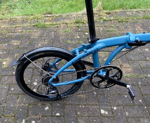

Here is the bike with the rear guard on. The "bracket" that came with it presumably for attaching at the seat stay bridge was just a flat piece of thin sheet steel with a slot in it, with wings that I assume you're meant to bend round the edges of the plastic guard to hold it in place. I thought if the guard gets knocked or a clump of mud goes inside it might dislodge the wings enough to foul the tyre and the steel is so thin it's sharp enough to slice the tyre up in this scenario. Also the bracket seems to assume the bolt hole on the bridge is perpendicular to the tyre and not facing it like on this bike.
I didn't like this solution so I drilled a hole through the plastic to bolt it to the seat stay bridge, with a washer each side to protect the plastic. The only adjustability of this is more or fewer washers but I think it's about right as it is.
